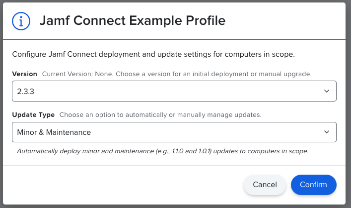

  1. In Jamf Pro, click Settings in the top-right corner of the page.
  2. Click Jamf Applications.
  3. Click Jamf Connect .
  4. Next to the configuration profile with the Jamf Connect settings you want to deploy, click Edit.
  5. Choose a version of Jamf Connect to deploy from the Version pop-up menu.
    Note:
    If a computer in the scope of the configuration profile already has a previous version of Jamf Connect installed, Jamf Pro will update that computer to the chosen version.
  6. Choose one of the following options from the Update Type pop-up menu to manage future updates:
    • MaintenanceAutomatically deploy maintenance (e.g., 1.0.1) updates to computers in scope.
    • Minor & MaintenanceAutomatically deploy minor and maintenance (e.g., 1.1.0 and 1.0.1) updates to computers in scope.
    • Manual
      Only deploy the chosen version to computers in scope and do not automatically deploy future updates.
    • NoneOnly deploy the chosen version to computers in scope that do not already have Jamf Connect installed. Computers that already have a version of Jamf Connect installed will not receive any updates.
  7. Click Confirm.
Jamf Pro deploys the chosen version of Jamf Connect when computers in the scope of the configuration profile check in and updates them accordingly as new releases become available.

Example:
Deploy the latest version of Jamf Connect and automatically deploy future updates.
